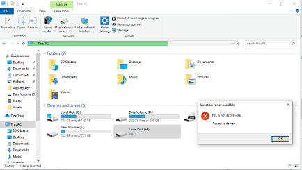

    I got the dreaded "[Drive] is not accessible" message after plugging my external USB hard drive into a new desktop computer.
    Workaround to access data when: External Hard Drive "is not accessible. Access is denied." 6415615f-91fa-4909-9fac-7fe11f66d4fc?upload=true.png
    The drive showed up fine in Disk Management, And after scouring the Internet for solutions, all of the Permissions were fine, as well is everything in the Security and Share tabs in properties. I even ran CHKDSK with no problems. Nothing I did allowed me to access the data on my drive.

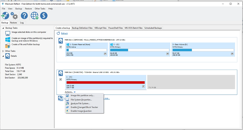

    After installing Macrium Reflect, select the "inaccessible" drive, and click the "Actions" button that is directly beneath it.
    Workaround to access data when: External Hard Drive "is not accessible. Access is denied." 1b879d7b-d09f-4f00-a793-d6163ec9abec?upload=true.png

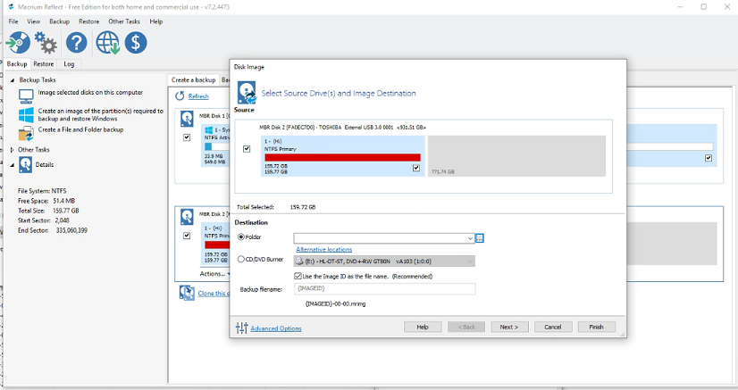

    Select "Image this partition only…," make sure that Folder is selected under Destination, and click the "…" button.
    Workaround to access data when: External Hard Drive "is not accessible. Access is denied." fe23d6d2-55d1-4fa4-b53f-bce0397ea940?upload=true.png

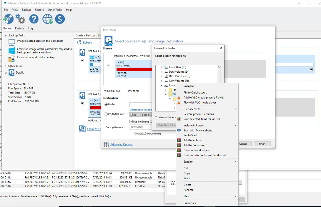

    When the "Browse for folder" window opens, you will be able to expand the drive and see the folders that are in the drive. You can Right click the folders and select Copy. This will allow you to paste the folder to another location, such as another external drive.
    Workaround to access data when: External Hard Drive "is not accessible. Access is denied." d3675969-843b-4039-a953-965528757350?upload=true.png
