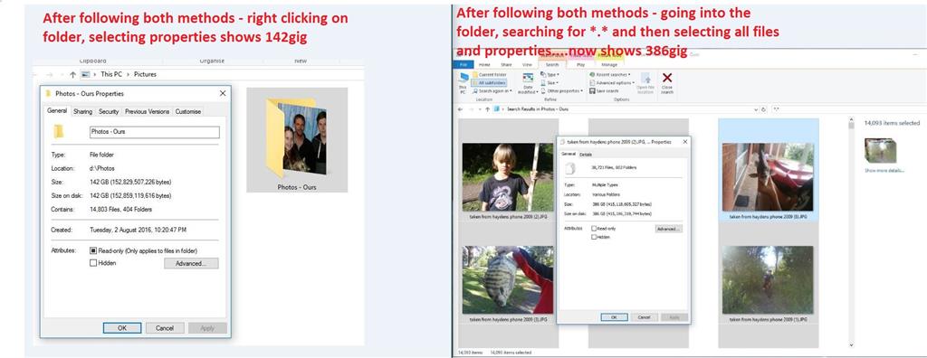

  3. Properties shows wrong size for files and folder
    I went through both methods (thanks alot for the help BTW) and retested the same pictures drive again, with both methods again
    Method 1 - right clicking on the folder...selecting properties, and reading the size on disk it reports
    Method 2 - opening up the folder, clicking inside the search bar and selecting *.* which shows every file and folder inside + all subdirectories. Confirmed theres no "grouping" its all just listed together. Select all files (control A) then right click and
    select properties...and reading the size on disk it reports

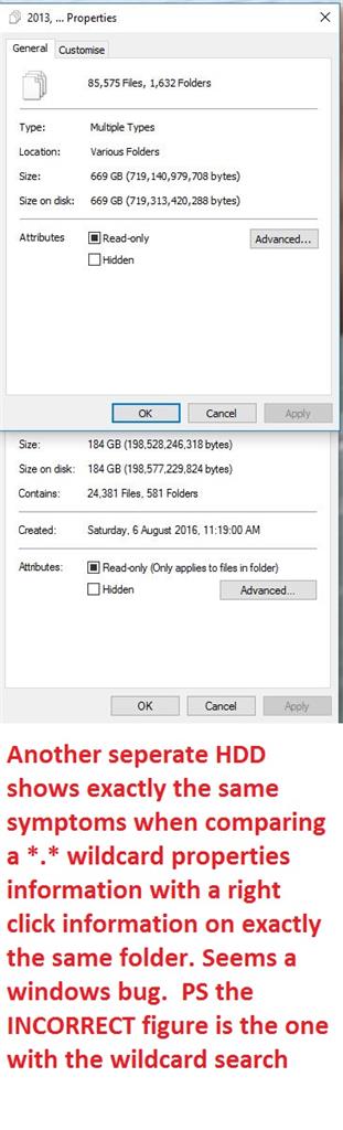

    Same results Im afraid. I retested another folder on a physically different hard drive using the same test - and also came up with ridiculously contradicting claims on how much data is in there
    Interesting hey Test 1 = 142Gig VS 386Gig
    Test 2 on a seperate HDD (physically seperate drive) 669Gig VS 184Gig
