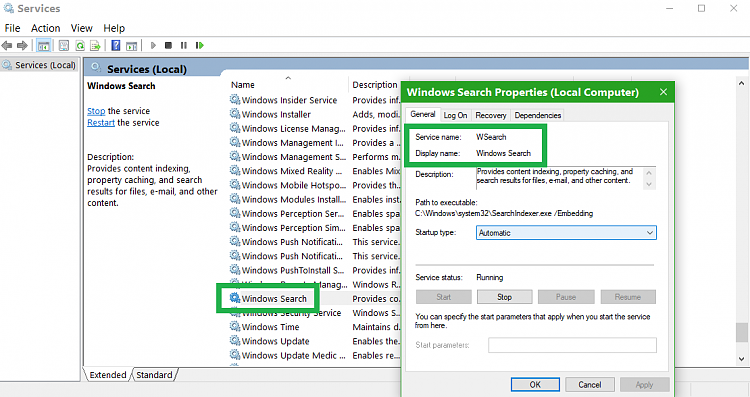

  3. pepanee Win User
    wsearch won't start, error 5 access denied
    I guess when the service itself has an issue, it renames itself to the "Service name" instead of "Display name".
    WSearch service not starting 369843d1656363197t-wsearch-wont-start-error-5-access-denied-image.png

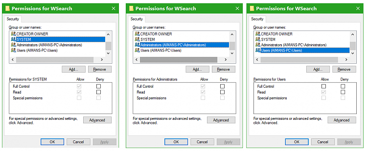

    Another idea, similar to: DHCP Client service Error 5: Access is denied
    1) Open Registry Editor and go to:
    2) Computer\HKEY_LOCAL_MACHINE\SYSTEM\CurrentControlSet\Services\WSearch
    3) Right click WSearch, and press Permissions...
    Do all these look similar on your computer? If not, then make them similar and restart your computer:
    WSearch service not starting 369845d1656364082t-wsearch-wont-start-error-5-access-denied-image.png
    After the computer restarts, see if Windows Search works
