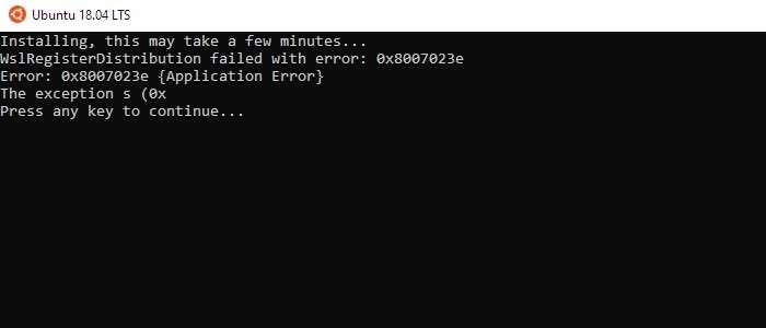

    WslRegisterDistribution failed with error 0x8007023e
    If you are receiving WslRegisterDistribution failed with error 0x8007023e when stating or installing any of the Linux Distro, then this post will help you fix it. The problem is an odd one and requires reinstalling almost anything related to VM, i.e., WSL, Docker, VM Platform, Hyper V, and so on.
    WslRegisterDistribution failed with error 0x8007023e WslRegisterDistribution-failed-with-error-0x8007023e.jpg
    Follow the steps below to fix the problem. This was offered as a solution that worked for many users. The shorter method will be to disable all VM features, reboot, and then reinstall. The longer version goes as below:

    • Now launch the Destro, and it should work now.
    While these are too many steps, it seems an uncommon issue and probably a bug that must be addressed. Reinstalling everything is the only solution that has worked for many, and it should work for you.
    I hope the post was informative and helped you resolve the WslRegisterDistribution failure with error 0x8007023e.
    It is possible that the error will occur everything there is a major shift in the working of WSL so keep this handy.
