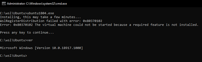

    When installing WSL, if you receive an error saying—WslRegisterDistribution failed with error: 0x80370102—then this post will help you resolve it. The Error occurs for a couple of reasons. Nested Virtualization, a limit on the CPUID, Virtualization support, and more.
    WslRegisterDistribution failed with error: 0x80370102 WslRegisterDistribution-failed-error-0x80370102-1.png
    Follow these suggestions to fix the problem.
    • Enable Nested Virtualization
    • Enable Hyper-V support at BIOS Level
    • Disable limitation on CPUID
    You will need admin permission and an understanding of BIOS to implement them.
    If you have installed Windows in a VM and then try to install WSL, you need to enable nested virtualization. Launch PowerShell with admin permission, and execute the command as mentioned below.
    Set-VMProcessor -VMName <VMName> -ExposeVirtualizationExtensions $true
    If this doesn’t work, you need to enable virtualization at the hardware level. This will depend on the BIOS or UEFI. More on this on the official Microsoft Documents.

    WslRegisterDistribution error 0x80370102
    I am trying to install Ubuntu 20.04 LTS on my PC, but it fails with an error message.
    Code:
    Installing, this may take a few minutes...WslRegisterDistribution failed with error: 0x80370102Error: 0x80370102 Der virtuelle Computer konnte nicht gestartet werden, da ein erforderliches Feature nicht installiert ist.
    Press any key to continue...
    My laptop is an Acer E5-551G, running Windows Home version is 2004, build 19041.329. Virtualization is supported and enabled (though no special menu in the BIOS), Hyper-V is enabled and started.

    "Error" Installing Linux distro in windows 10 pro wsl2
    Error: 0x80370102 The virtual machine could not be started because a required feature is not installed.

    Resolving WslRegisterDistribution error 0x80370102 when installing Linux Distro for WSL 2?
    # Encountering WslRegisterDistribution error 0x80370102 when installing Linux Distro for WSL 2
    I am currently on the `Windows 10 Pro Insider Preview build 18922.rs_prerelease`, and am trying to install a Linux distribution to access via Windows Subsystem for Linux (2). I have tried this for both the Ubuntu and Debian distros and have encountered the
    same error in each.
    I have successfully downloaded both distros from the Microsoft store, but when I try to first "run" the Ubuntu or Debian "app" the respective console comes up and prints the following text:
    Code:
    Pressing a key at this point automatically exits the console.
