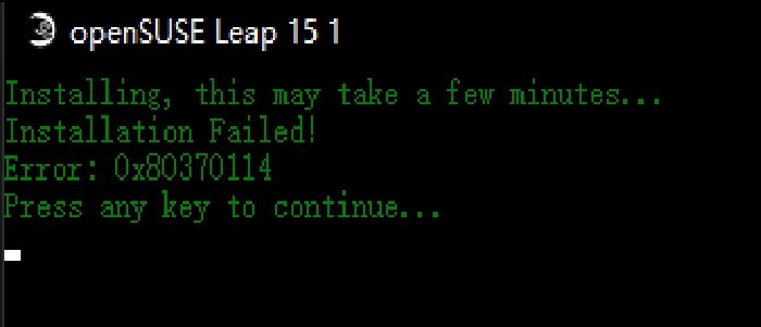

    WslRegisterDistribution failed with error: 0x80370114
    Hyper-V Host Compute Service, aka vmcompute.exe, is responsible make sure the Hyper-V service is up and running when needed. If the service is blocked, you will receive WslRegisterDistribution failed with error 0x80370114. This post helps you to resolve the problem and use WSL as expected.
    WslRegisterDistribution failed with error: 0x80370114 WslRegisterDistribution-failed-0x80370114-1.jpg
    Be aware that the same error code may also show an error message—
    Error: 0x80370114 The operation could not be started because a required feature is not installed
    The problem can be resolved using the same method.

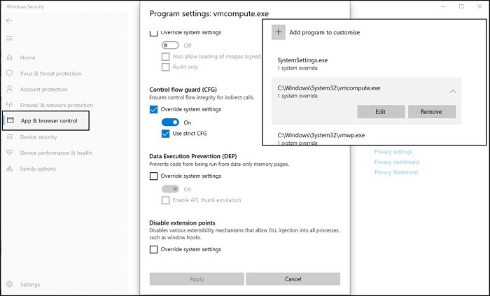

    To unblock the service, you will have to check with the antivirus or security solution. If you are using Windows Security, follow the steps as below:
    • Type Windows Security in the Start menu and press Enter to launch.
    • Click on App & Browser control available on the left side
    • Then click on Exploit protection settings at the bottom
    • Switch to the Program settings tab
    • Locate the Hyper-V Host Compute Service by going to the under mentioned path:
    C:\WINDOWS\System32\vmcompute.exe
    • Once included, select it, and then click on the Edit button
    • Locate Code flow guard (CFG) and uncheck Override system settings
    WslRegisterDistribution failed with error: 0x80370114 CFG-Override-Hyper-V-Host-Compute-Service.jpg
    Finally, open PowerShell, and execute the following command to start the service
    net start vmcompute
    Done that you can now set the WSL version if needed using the wsl –set-version <distro name> 2 command.
