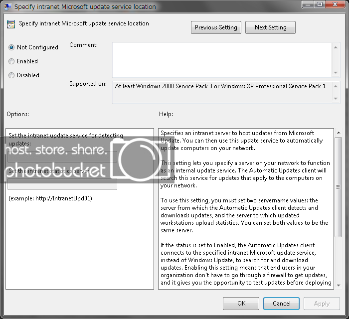

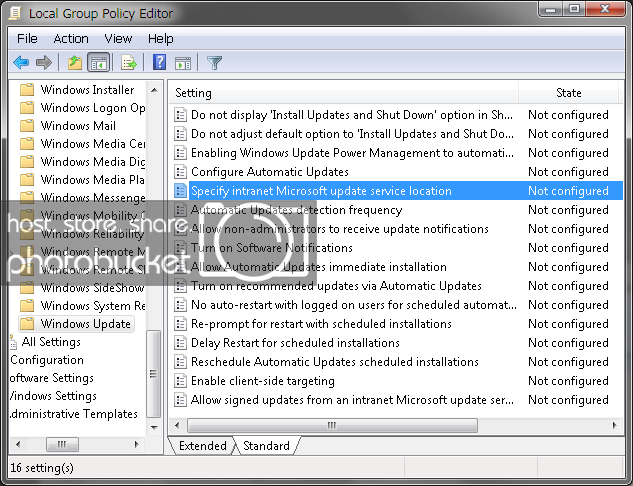

    - Click the Orb at the bottom left of the desktop aka 'Start' button
    - In the search field enter GPEDIT.MSC
    - In the Local Group Policy Editor (LGPE) console that appears, navigate to: Computer configuration > Administrative Templates > Windows Components > Windows Update
    - Double click the Specify Intranet Microsoft update service location Group Policy setting. Note that Not Configured is showing in the State column
    - The dialog box opens. Note that the Not Configured radio button is selected

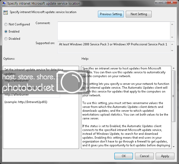

    - Enter the server details, by clicking the Enabled radio button and entering the same details in both Options fields. The server's name is the standard Windows name. My server is called afterburner *Smile Wsus server consulting :)

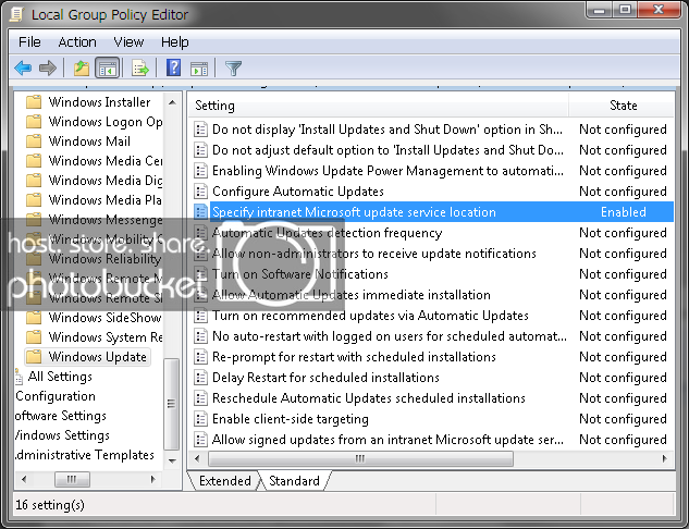

    - Click OK. The main LGPE window now looks like below. Note that Enabled is now showing in the State column.

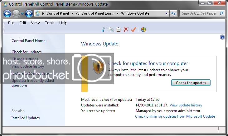

    - Open the Windows Update window. It should now show You receive updates: Managed by your system administrator
    Now, whenever you check for updates, Windows will access your WSUS server instead of looking over the internet to Microsoft's servers.
