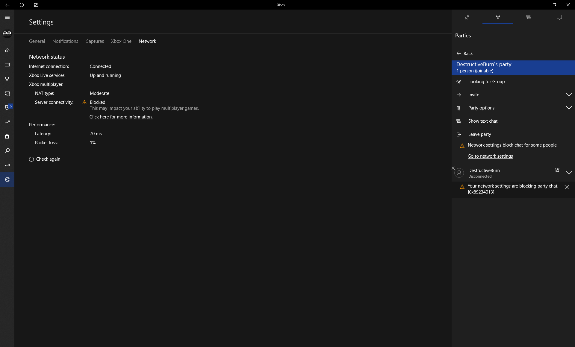

    Hello. First I would like to give the best-detailed information about my problem in hopes to try and get this working. This is technically my last option.
    I installed a fresh version of Windows 10 Home Premium on my
    Alienware Aurora-R4
    Intel(R) Core(TM) i7-3930K
    16 GB DDR3 RAM
    GeForce GTX 1080
    Everything works great. I haven't done much with it yet but I've been having issues with the Xbox App and I tried everything and I'm to the point of giving up on Windows 10 and going back to Windows 7.
    Xbox App NAT Moderate Server connectivity Blocked fb953c72-b5e0-4d22-b882-bb37e76653d5?upload=true.png
    So when I first saw the issue in the party chat saying ( Your network settings are blocking party chat. 0X89234013) I went ok. I'll probably need to open some ports.
    Just as a Note: I can play games online but the party chat is hopeless.
    So I opened these ports for my PC IP Address
    • Port 88 (UDP)
    • Port 3074 (UDP and TCP)
    • Port 53 (UDP and TCP)
    • Port 80 (TCP)
    • Port 500 (UDP)
    • Port 3544 (UDP)
    • Port 4500 (UDP)
    I checked NAT Type in Xbox Networking and it was Strict and Server connectivity is Blocked. I restarted the computer and the modem and no change. Also note, my Xbox One X is on the same line and it doesn't have problems.
    I followed the blocked issue on this link and everything is normal.
    https://support.xbox.com/en-US/xbox-on-windows/social/server-connectivity-xbox-app-displays-blocked

    There is one thing that actually did work a tad.
    In CMD Admin I typed in
    netsh
    int
    teredo
    show state
    set state client clientport-3544
    That broke teredo and so I used the (Fix it) button in Xbox Networking and that turned it from NAT strict to NAT Moderate
    show state, shows this.
    Type: natawareclient
    Server Name: win1807.ipv6.microsoft.com.
    Client Refresh Interval : 3544 seconds
    Client Port: unspecified
    State: qualified
    Client Type: teredo host-specific relay
    Network: unmanaged
    NAT: restricted (port)
    NAT Special Behaviour : UPNP: No, PortPreserving: Yes
    Local Mapping: 192.168.1.80:55534
    External NAT Mapping: Some IP that says it in my location but it's not my internet IP:55534
    So this is where I'm at. I installed Windows 10 for the Xbox App and everything I try does not work. It doesn't help Windows 10 is constantly changing and tutorials become pointless.
    I hope someone may have an idea because I ran out. I've been dealing with this issue for two weeks now and I lost all hope.
    BTW all the changes I did I made sure to keep it all original so no modified changes I did will affect everything.
    Hints to update your page Microsoft as CMD is not in the start menu as it's just Powershell in there now.
    P.S. The Netflix app doesn't work. Every time I hit play it just say's,
    Whoops, something went wrong: Error code U7363-1260-8004B823
    I tried it in Google Chrome and it Skips. I try it in Firefox and it works perfectly. Not sure if it's affected by this but I'm guessing so.
    DestructiveBurn, Mar 1, 2019
