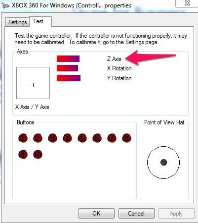

    You can tell by open the property windows of the xbox 360 controller in control panel
    the property window shows the controller have a z-axis (But it should have 2!)
    XBox Controller Z Axis Issue on Windows 10 3e1105c3-9d46-4fce-b2d3-b408be6af0df.jpg
    If you only press down LT the z axis will decrease, if you only press down RT z axis will increase
    but if you press both LT and RT it will cancel each other out just like nothing pressed.
