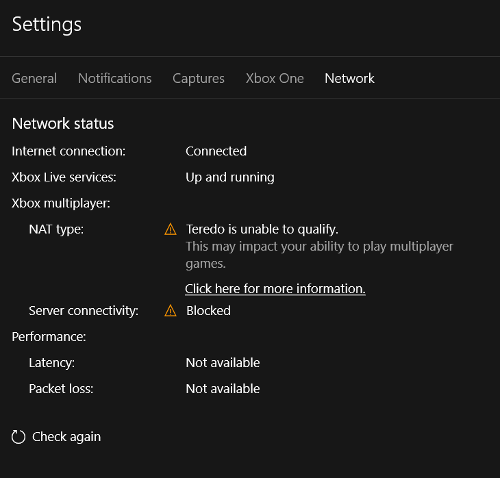

    When I looked at the Console Companion network information, I got the following:
    Xbox for PC Missing Teredo Tunneling Driver, not on Legacy Hardware c5c622e7-c4da-4092-ae1e-46a337430914?upload=true.png

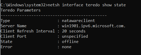

    Went to the command line to look at Teredo, got this:
    Xbox for PC Missing Teredo Tunneling Driver, not on Legacy Hardware a00f8dd9-1394-4bc5-be35-727f00e56759?upload=true.png
