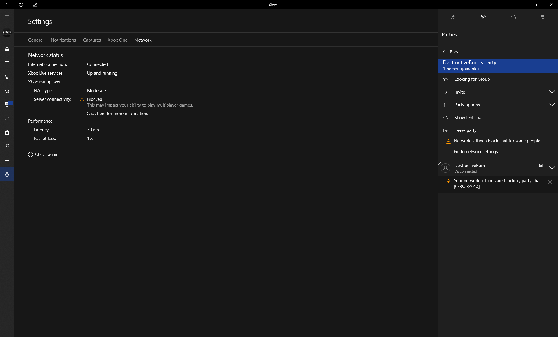

  3. NAT type: Moderate and Server connectivity is Blocked in Xbox App
    Hello. First I would like to give the best-detailed information about my problem in hopes to try and get this working. This is technically my last option.
    I installed a fresh version of Windows 10 Home Premium on my
    Alienware Aurora-R4
    Intel(R) Core(TM) i7-3930K
    16 GB DDR3 RAM
    GeForce GTX 1080
    Everything works great. I haven't done much with it yet but I've been having issues with the Xbox App and I tried everything and I'm to the point of giving up on Windows 10 and going back to Windows 7.
    Xbox Live App Moderate NAT and Server Connectivity Blocked fb953c72-b5e0-4d22-b882-bb37e76653d5?upload=true.png
    So when I first saw the issue in the party chat saying ( Your network settings are blocking party chat. 0X89234013) I went ok. I'll probably need to open some ports.
    Just as a Note: I can play games online but the party chat is hopeless.
    So I opened these ports for my PC IP Address

    I checked NAT Type in Xbox Networking and it was Strict and Server connectivity is Blocked. I restarted the computer and the modem and no change. Also note, my Xbox One X is on the same line and it doesn't have problems.

    There is one thing that actually did work a tad.
    In CMD Admin I typed in
    netsh
    int
    teredo
    show state
    set state client clientport-3544
    That broke teredo and so I used the (Fix it) button in Xbox Networking and that turned it from NAT strict to NAT Moderate
    show state, shows this.
    Type: natawareclient
    Server Name: win1807.ipv6.microsoft.com.
    Client Refresh Interval : 3544 seconds
    Client Port: unspecified
    State: qualified
    Client Type: teredo host-specific relay
    Network: unmanaged
    NAT: restricted (port)
    NAT Special Behaviour : UPNP: No, PortPreserving: Yes
    Local Mapping: 192.168.1.80:55534
    External NAT Mapping: Some IP that says it in my location but it's not my internet IP:55534
    So this is where I'm at. I installed Windows 10 for the Xbox App and everything I try does not work. It doesn't help Windows 10 is constantly changing and tutorials become pointless.
