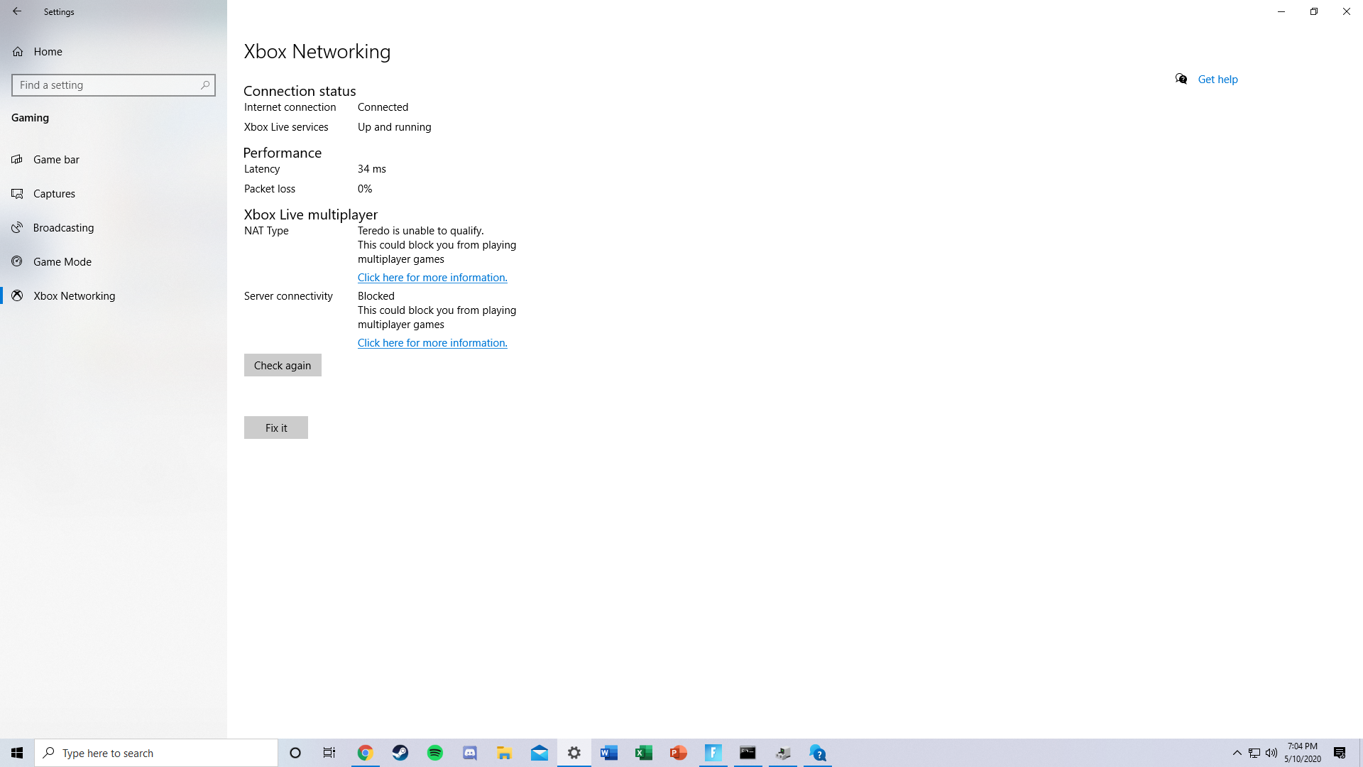

Discus and support Xbox Networking - "Teredo is unable to qualify" in Windows 10 Customization to solve the problem; Hello, I have an issue with Windows 10 that is not allowing me to join Xbox parties. I have tried everything on this guide:... Discussion in 'Windows 10 Customization' started by kyjgohr, May 10, 2020.

  2. XBOX: Teredo is unable to qualify
    Hi Will,
    The Teredo is unable to qualify error means that your PC is unable to obtain a Teredo IP address.
    Failure to obtain a Teredo IP address can occur when there’s an issue with your Teredo adapter, when a device on your network is blocking the Teredo protocol or if there’s software installed on your PC that’s disabling Teredo functionality. Without
    a Teredo IP address, you’ll be unable to use party chat or do multiplayer gaming on Xbox Live.

  4. Junaid_A Win User
    Teredo unable to qualify
    Hi JayKay,
    Failure to obtain a Teredo IP address can occur when there’s an issue with your Teredo adapter, when a device on your network is blocking the Teredo protocol, or if there’s software installed on your PC that’s disabling
    Teredo functionality. If you haven’t tried the methods listed in the following articles yet, I would suggest you to try them first and see if it works:
    Note:
    Serious problems might occur if you modify the registry incorrectly. Therefore, make sure that you follow these steps carefully. For added protection, back up the registry before you modify it. Then, you can restore the registry
    if a problem occurs. To backup and restore registry key, refer to this
    link.
    If the issue persists, I would suggest you to
    uninstall
    and re-install the Xbox app to see if you can get it to work.
    • Right click the Windows icon on the taskbar and choose Windows PowerShell (Admin).
    • Copy and paste the following command and hit Enter:
      Get-AppxPackage Microsoft.XboxApp | Remove-AppxPackage
    • Reboot the computer once the command is executed.
    • Once the machine restarts, launch Microsoft Store and reinstall the Xbox app.
    After reinstalling the Xbox app, open Windows PowerShell (Admin)
    again and copy paste the following command to enable Teredo.
    netsh interface Teredo set state type=default
    Let us know how it goes.
