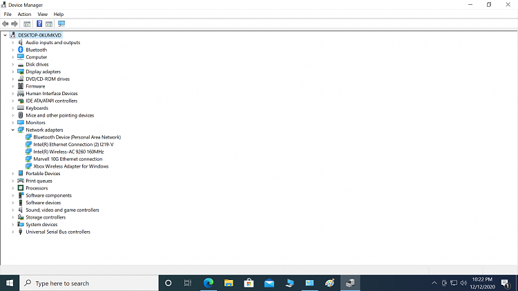

  4. Xbox wireless adaptor APPCRASH dwm.exe fault module gameinput.dll
    Xbox wireless USB adaptor ACC
    Thanks for the reply. The controller itself isn't even part of the issue, it's the UBS wireless adaptor. I just installed the optional driver update (xbox-net 1.0.46.1) and the problem went away. I was looking for the driver and don't want to install an app, (xbox accessories) that I don't need.
    Xbox wireless adaptor APPCRASH dwm.exe fault module gameinput.dll 310481d1607829780t-xbox-wireless-usb-adaptor-acc-xbox.png
    leosantare, Apr 6, 2023
