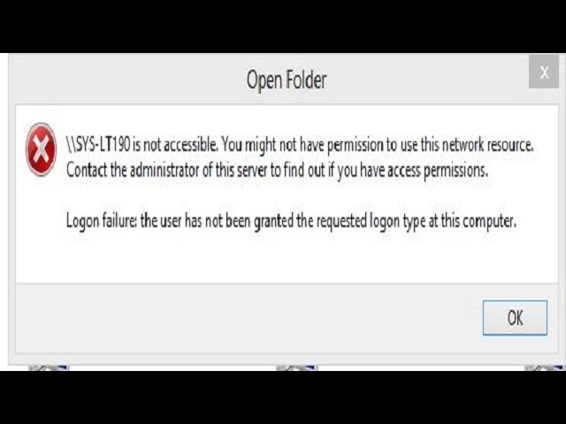

  2. Whats How Win User
    PC is not accessible. You might not have permission to use this network resource Contact the administrator of this server to find out if you have access permissions
    You do not have to permission to access (shared network resource) contact your administrator 5314c4b7-4964-459f-9bdf-3cdb4bee85e6.jpg
    Please go through it may help you....
    You might not have permission to use this network resource | Contact the administrator : Solved.
    Solution 1:- Watch
    Error Message:- \\Localhost is not accessible. You might not have permission to use this network resource. Contact the administrator of this server to find out if you have access permissions.
    Step 1 :- disable the antivirus.....program
    step:- 2.. check the firewall settings..
    Steps 3:- go to control panel..... user account ....... manage credentials............ and from the save password
    valet remove from the list of the save password and open again the network... and remove the save credential.

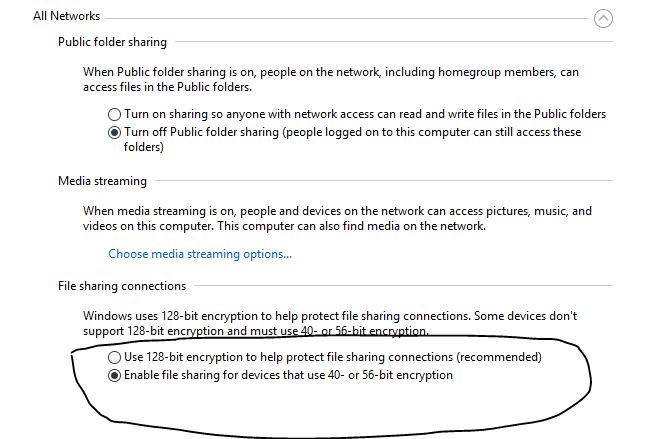

    Solution 2:- Control Panel > Network and Sharing Center > Advanced sharing settings > All networks Choose option
    Enable file sharing for devices that use 40- or 56 bit encryption.
    You do not have to permission to access (shared network resource) contact your administrator 962caea8-bbb1-4d50-a9dd-0c86f008751c.jpg
