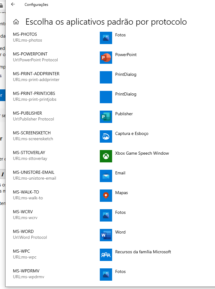

    When i go and take a look at the standard apps linked to protocols by going to settings - apps - default apps - set default apps by protocol, the ms-screenclip-link protocol is missing. I only get the ms-screensketch protocol. I think when i fix the protocol,
    so fix that i will have the missing protocol, the windows-shift-s shortcut will start working again.

    The protocol ms-screenclip is missing from the Default Program as seen:
    You'll need a new app to open ms-screenclip link b94f36bb-da58-4ff1-b9b8-3747f98c550a?upload=true.png
    But it does exist in registry:
    You'll need a new app to open ms-screenclip link 29a786e2-22dd-47ed-8bba-968b89fb89ad?upload=true.png
    But I was unnable to make it work.
