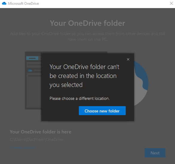

    I have OneDrive folder at default: C:\Users\MyUsername\OneDrive I want to move OneDrive to C:\OneDrive. So I select OneDrive Settings - Unlink PC, then log in to my OneDrive account again and chose C as the folder location. I got the message "Your OneDrive folder can't be created in the location you selected".
    “Your OneDrive folder can't be created in the location you selected” error when moving... b47a68b8-cfc7-4e82-8a31-8ef7be77c1b6?upload=true.png
    I tried to move it to a secondary drive D:\OneDrive and it worked without issues.

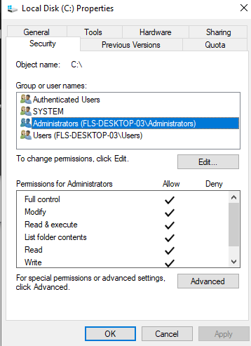

    I checked the security settings of C drive and it shows this I am an administrator
    “Your OneDrive folder can't be created in the location you selected” error when moving... b2860b64-a398-4913-bdbb-3a88428bf55f?upload=true.png

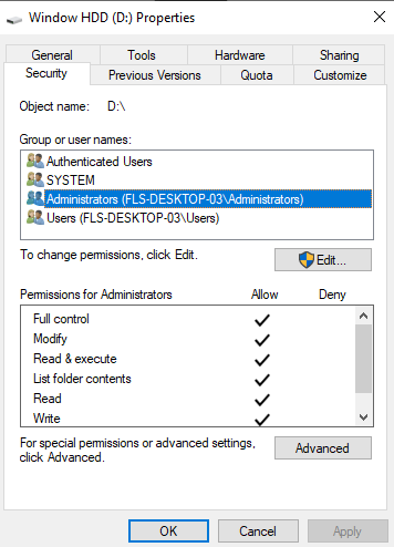

    By the way the security settings of my D drive is the same:
    “Your OneDrive folder can't be created in the location you selected” error when moving... fe9fc59d-bf0c-4966-b237-f082a5da0d81?upload=true.png
