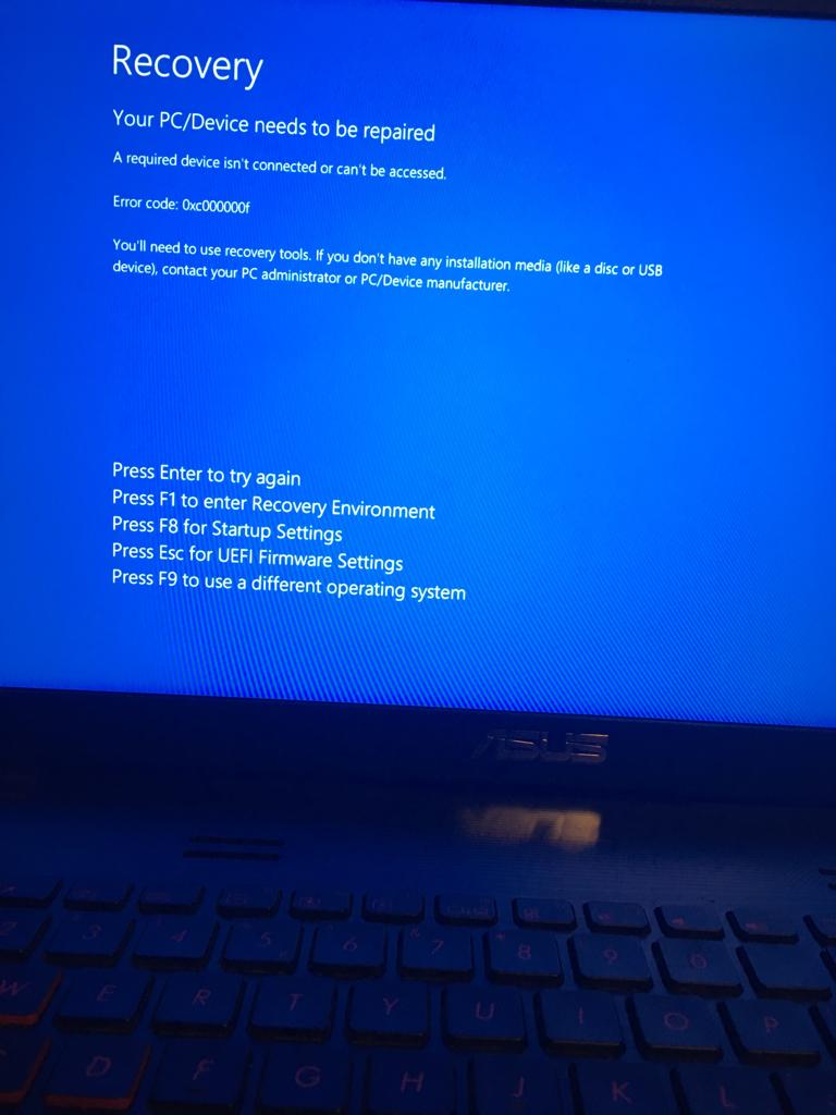

    Hello! I have an Asus ROG GL552VX laptop. My problem is that after some kind of update, I think I forced shut down my laptop and then, when it booted up, a blue screen appeared saying that "Your PC/Laptop needs to be repaired 0xc000000f".
    Your PC/Laptop needs to be repaired 0xc000000f - cannot repair windows f78fe3d2-ff7e-40e3-ae4f-1dbe0f8acca2?upload=true.jpg

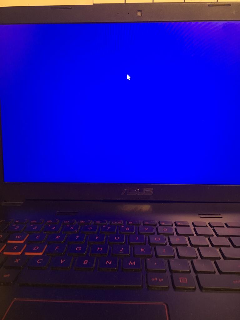

    I made a USB DRIVE containing the windows, I booted up from it, but then I got stuck on another problem. My laptop froze on the blue screen on the windows installation manager.
    Your PC/Laptop needs to be repaired 0xc000000f - cannot repair windows d1a49f09-257d-475e-a579-4f7d584c932a?upload=true.jpg
    Initially I thought that it was stuck, than, after 15 to 30 minutes I think, the windows installation manager box appeared (the one with the language, time etc). I chose English and when I tried to do "Repair your PC", I got stuck again on the blue screen (the picture above). I don't know what to do. Firstly, I thought that there was a problem with my USB stick, I replaced it, and nothing changed.
    I don't know what to do... please help!

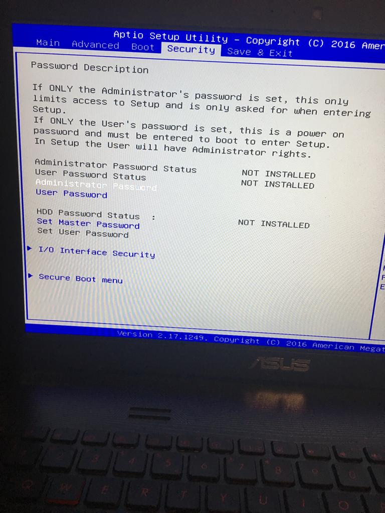

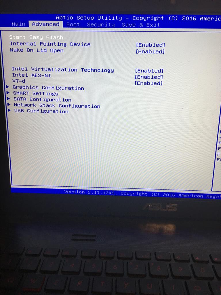

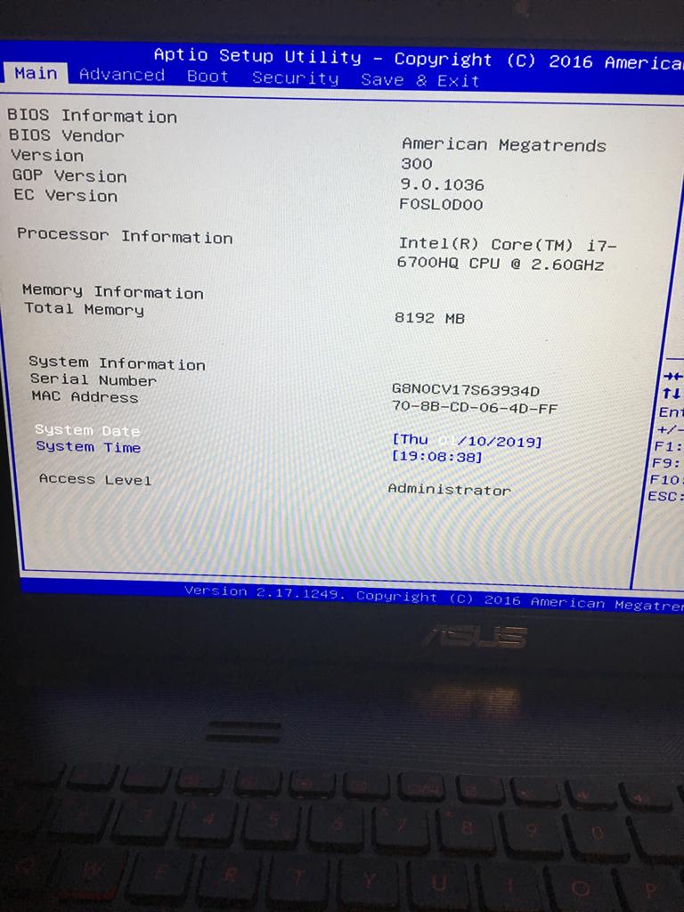

    My bios settings:
    Your PC/Laptop needs to be repaired 0xc000000f - cannot repair windows d442629f-697c-43c1-99be-01721b9456ed?upload=true.jpg
    Your PC/Laptop needs to be repaired 0xc000000f - cannot repair windows 91fd7f57-20f7-4123-a894-6d8be5834098?upload=true.jpg
    Your PC/Laptop needs to be repaired 0xc000000f - cannot repair windows b640b2b5-1e6d-47b1-802f-e52742dbb9cb?upload=true.jpg
    Your PC/Laptop needs to be repaired 0xc000000f - cannot repair windows 7b29a2b5-d8d1-464c-a8be-0df6f95f2315?upload=true.jpg
    Do you think it is a problem with my HDD?

    I would try the following steps in order:
    1. Remove the laptop main battery for a few minutes - may reset something
    2. Load BIOS defaults
    3. Install Macrium Reflect Free on another PC, create a Reflect USB repair disk then use that disk to repair your laptop
    4. Recover from backup if you have one
    5. Perform a Windows 10 repair install - see instructions on this forum
