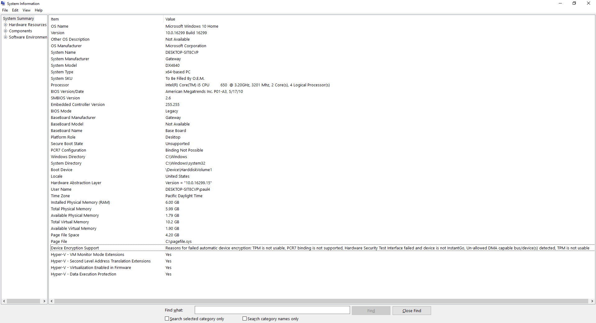

    I bought my Gateway PC in 2010 and lately I have had very serious updating problems!
    The following is my System Info November 2019:
    Failed fresh Windows 10 re-install from Version 1709 to Version 1903 with catastrophic BSOD... 7cc02f86-0ddb-4cbf-ad4d-e7848ad27cc9?upload=true.png
    Since the first week of October 2019, when I started my PC it started acting up to a point where it had gone into a catastrophic Blue Screen Of Death (BSOD). Since June, my PC was successful in updating to Version 1803 from Version 1709. I own an original MS Windows 10 Version 1709 installation disk and although it did update to V.1803, my PC started acting up a few weeks ago to a dead-end point!
    I have done anything and everything possible to try and reinstall my original V.1709 disk trying to update to V.1903 now with complete failure, so I tried to update to the older V.1803 also with complete failure!
    For the last few weeks I've reinstalled my V.1709 disk about 20 times doing everything from running a SFC Scannow, DISM Restore Health command scan, do the update....failed!
    I've gone to the Services tab disabling Windows Update in the Startup Type tab, do the update....failed!
    I've gone to C:/ Windows and deleting the contents of the SoftwareDistribution file, do the update....failed!
    I've gone to the Power and Sleep tab and setting my system to Never sleep nor power down the screen, do the update....failed!
    I've gone to the Date and Time tab, turn the system to on in the Set time automatically, do the update....failed!
    I've unplugged everything from my PC only leaving the mouse and the screen, do the update....failed!
    I've even unplugged my SSD and plugged in a new (formatted) HDD drive and tried reinstalling my Windows 10 and then restart only for it to go into a BSOD.....again failed!
    I've done everything as said numerously and again trying to update to the newer versions after everything and anything possible that I've done, restarted my PC, it goes into Update mode on log in and then it freezes at about 30% forcing me to do a hard start only to go into BSOD (with the sad face frozen) screen......all failed!
    The best I've succeeded was to get up to 90% updates only to completely freezes and completely fail!
    Now I'm not a gamer, and I realize my system is old but also I do know what I'm doing keeping my system optimized with updated files from my Device Manager and I've been using Bitdefender Total Security antivirus services for 9 years now with no problems, but one week ago, I've replaced my 10 year old display graphics adapter card with a brand new NVIDIA GeForce GT 710 adapter and as said, I've tried troubleshooting in the Settings Update and Security tab and then updating and restarting, only ending in BSOD.
    About 10 months ago, my old HDD crashed altogether, so I installed a brand new Samsung SSD drive for my dedicated C:/ Windows system and installed a second HDD for all my other media and this really increased my performance running at under normal temperatures but about 4 weeks ago, I noticed that while right in the middle of using my PC, this is when my problems started going into BSOD. I've restarted and it wouldn't even go into log in and this happened a few times forcing me then to do a complete reinstall of my MS Windows disk.
    I suspected that maybe my PSU has failed but it hasn't because what I've done now, is doing a fresh reinstall of my MS Windows V.1709 disk and it installs with no problems all right up to this point where I am using my PC to write all this out here and everything is mysteriously running perfectly!
    My system has at the moment updated itself from the Update Status with it's showing all the necessary updated V.1709 Security files and even the included Feature update to Windows 10, Version 1903 file and it's prompting me to do a restart which I have NOT DONE now for 3 days leaving my PC permanently on!
    After fully reinstalling my original V.1709 disk and removing it from my PC, I have tested what I can by even disabling my current Internet service and forcing my system to go into Sleep mode over-night now for the last 3 days and I'd simply wake it up by pressing any key and it lights up perfectly and here I am using my system with ZERO problems, but I know that if I re-started my PC at this moment, it would crash and completely freeze forcing me to reinstall my Windows V.1709 disk again, removing the disk and continue on where I am right now using my system flawlessly!
    This is making me so-ooooo sick and tired and warned out and stuck in a weird loop where I cannot restart after an update but I can use my PC after and install.......ANYONE PLEASE PLEASE PLEASE HELP HELP HELP.........Thank-you
