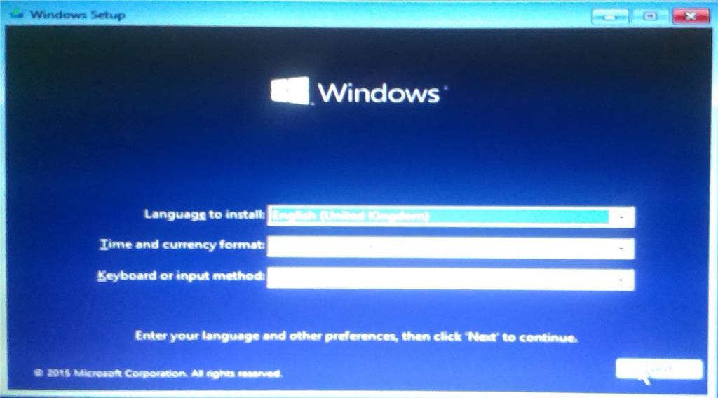

    4 You will then see a dialog asking you to choose the language, time-currency & keyboard region,
    How to - Escape from an MSConfig-induced Safe mode boot loop 3909ce2b-7201-43f7-a622-578ffdd73232.jpg
    5 Then click on the button in the bottom right [labelled Next],

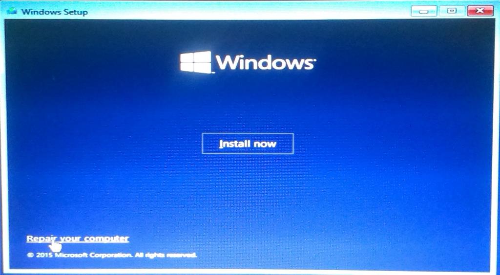

    6 Then you'll be taken to the main Install page but do not choose that - click on Repair your computer instead. Remember that you are not trying to reinstall Windows, you are just using the installation USB as a repair tool.
    How to - Escape from an MSConfig-induced Safe mode boot loop e7382bf3-d23a-4f85-a771-5b8246ecdfad.jpg

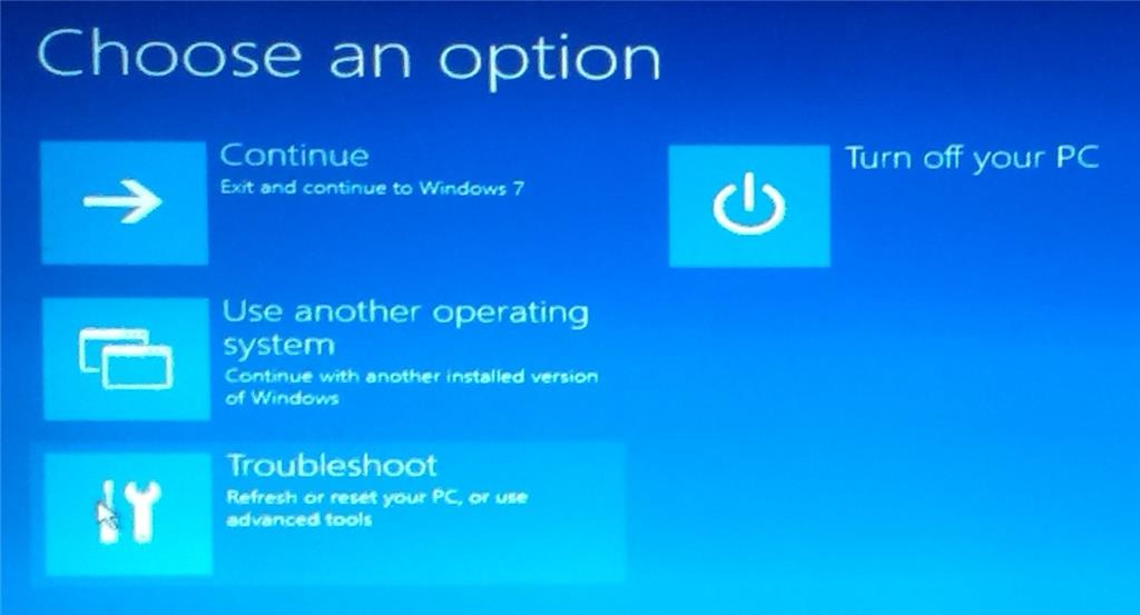

    7 Then you'll see the Choose an option screen,
    How to - Escape from an MSConfig-induced Safe mode boot loop 034e7c81-6185-4ab6-88e5-5279d91d5bd4.jpg

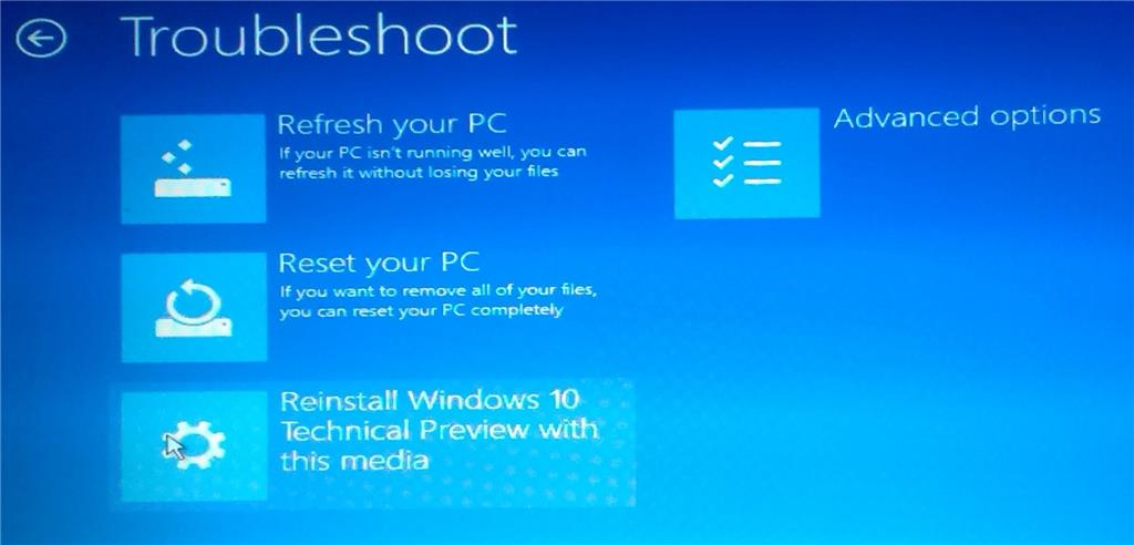

    8 Click on Troubleshoot to go to the Troubleshoot menu,
    How to - Escape from an MSConfig-induced Safe mode boot loop af1835e3-76e2-4a54-ac85-4083ef1ed477.jpg

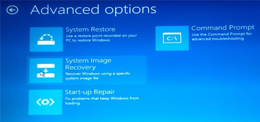

    9 Click on Advanced options,
    How to - Escape from an MSConfig-induced Safe mode boot loop 244b9ba5-d661-490c-86fc-b83b04a50454.jpg

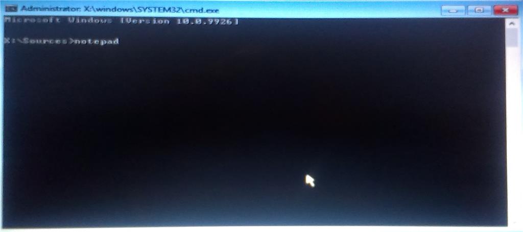

    10 Click on Command prompt,
    How to - Escape from an MSConfig-induced Safe mode boot loop f9e59ffc-fc6b-467d-b98c-e01a6f76318e.jpg
    11 Enter this
    BCDEdit

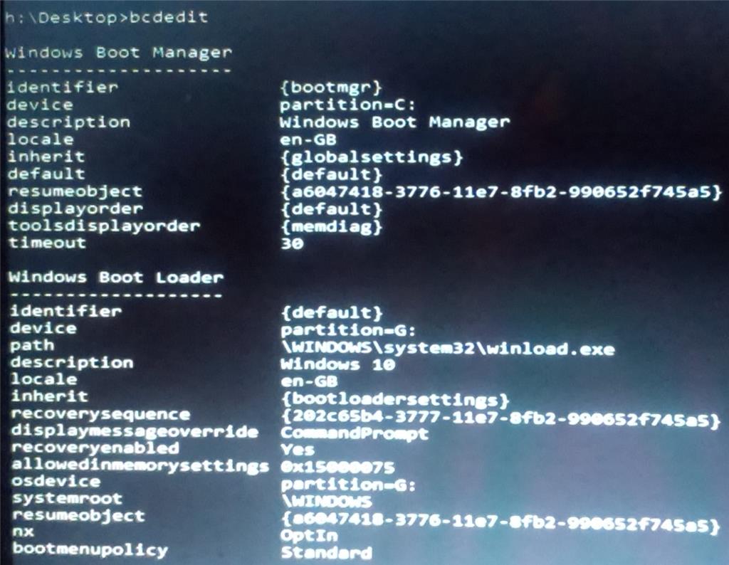

    12 You will get a response like this -
    How to - Escape from an MSConfig-induced Safe mode boot loop 61509df9-2045-4561-a1cc-e15f03b1297b.jpg
    13 Look at the line that says Windows 10 then look up three lines to the "identifier" where mine says {default} [and yours probably will too].
    14.1 If yours does also say {default} then enter this [including its brackets, just as shown]
    bcdedit /deletevalue {default} safeboot
    14.2 If yours does not also say {default} then enter whatever it does say inside the curly brackets [including its brackets, just as shown]
    bcdedit /deletevalue {WhatEverItDoesSay} safeboot
    15 That's it, all done.
    16 Close the Command prompt [The menu screen might then close automatically but if not you can just click on the back arrows until you reach the Choose an option screen where you can click on Turn off your PC].
    17 Turn the computer back on and it should now boot straight into Windows properly and not into Safe mode.
