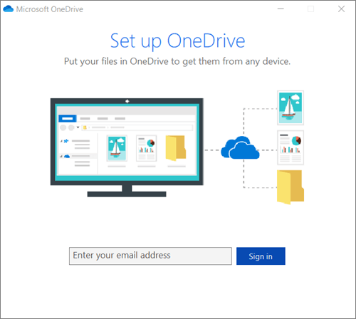

    4. After your computer restarts, select the Start button, search for “OneDrive”, and then select the
      OneDrive desktop app.
    5. When OneDrive Setup starts, enter your personal account, or your work or school account, and then select
      Sign in.
      Onedrive Files on Demand not working as described b2cd13c5-7d45-4203-b09c-26a8780e589f.png
    6. Follow the instructions to
      Turn on Files On-Demand
