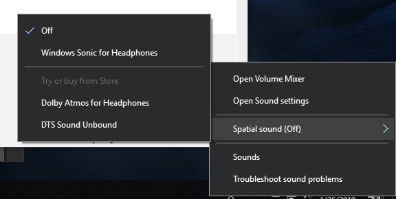

  2. No option to enable Dolby Atmos for Headphones?
    I had Dolby Atmos for Headphones working on an old PC. I decided to upgrade and when I did I realized I was no longer able to select Dolby Atmos for Headphones in my spacial sound settings. I installed the app and when I did, the Spacial Sound setting changed
    from "Dolby Access" to "Dolby Atmos for Headphones"
    Why does the Dolby Atmos for headphones option disappear when Telemetry is disabled? 2560ac67-feb0-46a8-8bf7-59f7d148b6f9?upload=true.png

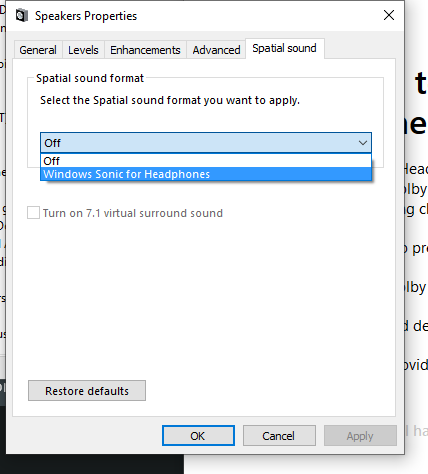

    However, when I go into preferences for my device and look at the spacial sound settings, I am greeted with this...
    Why does the Dolby Atmos for headphones option disappear when Telemetry is disabled? 5559fd0f-6944-40e8-a285-ad341f02ba03?upload=true.png
    No option to enable Dolby Atmos for Headphones.

  3. Dolby Atmos for headphones not selectable in spatial sound
    Thanks all for assisting, I now have the option for Dolby Atmos for headphones. This was fixed by following instruction from Dolby Atmos support, completely terminating the Dolby Access process via the task manager is what
    fixed my issue. Below is the instructions sent by Doby Atmos support for anyone with the same issue to try.
    Code:
    Hi there!
    Thank you for reaching back out to Dolby Atmos support!
    In our testing we have found that reinstalling Dolby Access and completely restarting your device should restore Dolby Atmos.
    If not, please try completely terminating the Dolby Access process via the task manager. Please note, you need to keep Dolby Access open when doing this so that is shows in the apps list. This method will not work if simply closing the app normally using the
     X button. To accomplish this:
    1. Open Windows task manager: Right-click in your system taskbar and choose task manager or choose the option after pressing ctrl-alt-del.
    2. Find Dolby Access in the apps list, select it, then choose the End task button. This should end the Access app and also associated background processes.
    3. Double-check in the Background processes list that "runtime broker" is also ended. If listed, please end this as well. Now, please launch your Dolby Access application and configure your sound settings from directly within Dolby Access.
    If this does not resolve your issue, right click the volume icon in the system tray and select 'playback devices.' Then, right click your audio device and choose 'properties.' Finally, find the Enhancements tab and uncheck 'Disable all enhancements.'
    Next, please ensure your audio isn't set to Mono or one channel sound. In Windows, search for your Settings, and choose Ease of Access. In the Audio section, you will see an option to turn on MONO. Make sure this is turned OFF. Once this is off, enter your
     audio settings to configure Dolby Atmos again.
    If this is not checked, then please navigate to your ‘Apps & Features’ folder on your PC via the Cortana search bar. Within Apps & Features, ensure there are folders for both ‘Dolby Access’ and ‘Dolby Atmos for Headphones’. It is very important that you have
     both of these files as these are needed for you to be able to use Dolby Atmos for Headphones on your device.
    If you see both of these files, click on ‘Dolby Atmos for Headphones’ and uninstall this from your PC. Once complete, open the Dolby Access application and reinstall Dolby Atmos for Headphones from there.
    If you only see ‘Dolby Access,' please click on it and select 'Advanced Options,' then 'Reset.' Once complete, open the Dolby Access application and install Dolby Atmos for Headphones from there.
    We appreciate your patience, and hope you have a wonderful day!
    The Dolby Support Team
    JimboJones122, Sep 11, 2019
