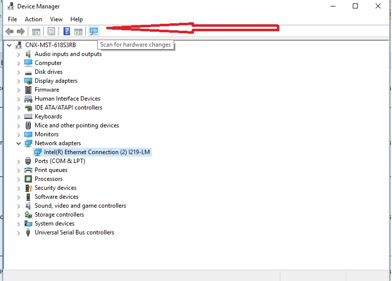

    Since you've installed the Windows 10 Creators update, you should also update the WiFi adapter to resolve the issue. You may check for the latest driver of your WiFi adapter through Device Manager. To do so, please follow the steps below:
    • Press Windows key + X, then select Device Manager.
    • Under Device Manager, double-click Network adapters.
    • Right-click on your wireless adapter, then click Properties.
    • Under Properties, click Driver tab.
    • Click Uninstall.
    • Once you're done, click OK.
    • Left-click on the wireless adapter to highlight it.
    • Click Scan for hardware changes to search for the most updated driver for the device.
    WiFi issue after the new build update 2a85f1ca-5ead-4542-b6a7-881f9ea2fd0f.jpg
    Feel free to post back with the result for further assistance.
    I did that but no new driver was offered. I then went to the Intel site but it also didn't offer a new driver for their Centrino N-2230 WiFi card. This was a clean install of Creators Update so all the latest drivers should be installed.
    But as I said, this seems to be an issue with Win 10 Creators Update's "automatically connect" feature,
    not with the WiFi driver. As soon as I manually connect to my network, everything works ok. It should be connecting to the network automatically as soon as Win 10 finishes loading.
    Windows is acting as though "automatically connect" is not checked for my network, even though there's a checkmark in that box when I open the list of available WiFi networks.
