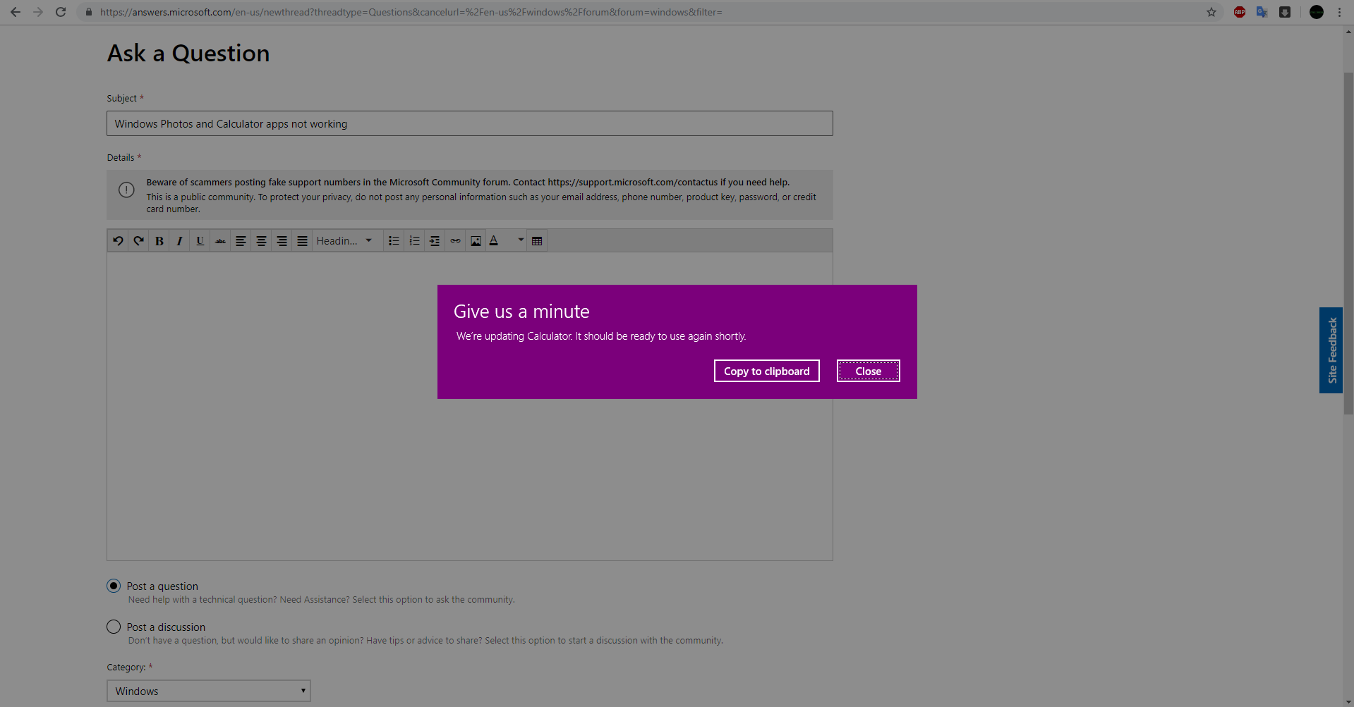

    This error keeps showing up when i open calculator or photos. It says they've been updating but this happened 2 weeks ago and it still happens. I tried checking for updates but nothing happened. How can i fix it? Windows Photos and Calculator apps not working 7995e967-f8cd-495e-8c73-c886b23ea355?upload=true.png
