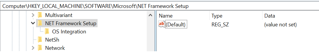

    I am trying to fix a computer that is no longer running games as it is looking for the .net 4.5 or greater framework to be installed already. I looked to see what was installed via the registry and found that the system doesn't have any record of any .net framework being installed.

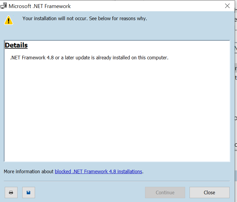

    I downloaded an offline copy of the 4.8 framework and tried to install, but that just said that the 4.8 or greater has already been installed.

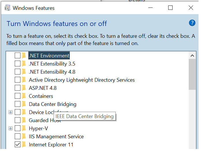

    the option to turn it on/off also doesn't exist. Turning on the .net exensibility or the asp.net 4.8 doesn't leave them installed.

    I am unable to move onto gaming until i get this resolved too. Every time I try to start a game it asks if I want to install a framework and fails. All the other answers online keep asking to see the registry but that never worked for me because the folder is just empty.

    I suggest you to follow the below steps to check whether the .NET Framework 3.5 has been installed or not.
    • Press Windows+X and then select programs and features.
    • On the left hand side click on the option “turn windows features on or off”.
    • Check whether the “.NET Framework 3.5” has been checked or not.
    • If not check then I suggest you to check it and then install it.
