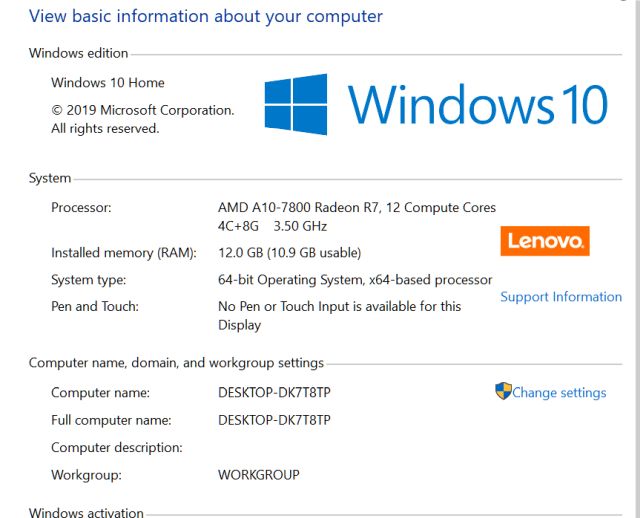

    This is a snapshot of my system ...
    Add or Remove Turn off hard disk after from Power Options in Windows SYSTEM-SPECS.jpg
    mrclose, Oct 26, 2019
