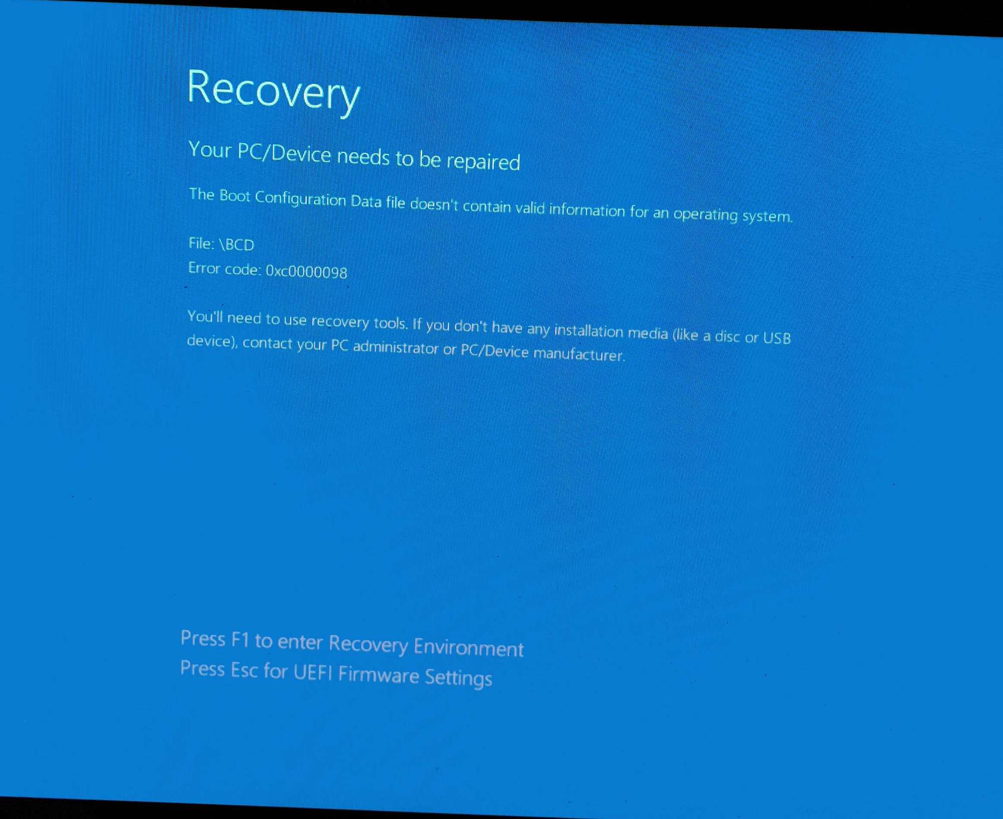

    Hi Community,
    A week ago, my computer started giving me a "Blue Screen Error" with a "SYSTEM_SERVICE_EXCEPTION" message. It said that I should go to www.windows.com/stopcode . The site gave me instruction that began with getting the Computer into Windows Recovery Environment aka WinRE shutting and restarting the computer three times. But as I tried getting into WinRE, another error message came up.
    I am herein attaching three images. One will show the original error message (it has a QR code on it) & one image will show my second error message.
    Can anyone help me to understand what my next step to solving this problem should be?
    Thank you in advance,
    ShimsF

  3. Black screen and flashing cursor after latest windows update.
    Hi Andrew,
    Let us try repair your device first by accessing the Windows Recovery Environment (WinRE). Kindly force restart your device continuously until Windows loads. If Windows does not load, it should automatically enter the
    We can then try to repair the startup files for Windows. Here are the steps:
    • In the Windows Recovery Environment (blue screen menus), select See advanced repair options > Troubleshoot > Advanced options > Startup Repair.
    Let us know how it goes.
    Jamille Nar, Nov 12, 2019
  4. Blue Screen Error ; Fail to enter Windows Recovery Environment (WinRE)
    Dell laptop stuck on Getting windows ready screen
    To resolve your concern, we suggest that you continue to force restart the computer until Windows loads. If Windows does not load, it should automatically enter the
    Windows Recovery Environment (WinRE). We can then try to repair the startup files for Windows. Here is how:
    If it does not load Windows nor gets into WinRE, we will need to manually get to
    WinRE. Here are the steps:
    • Force shutdown your computer by pressing and holding the power button down for 5 to 10 seconds.
    • Turn it back on and when you see the screen with the loading dots, force shutdown the PC once more. Make sure that you perform the force shutdown once you see the loading dots. You will need to do this twice.
    • The third time you turn the PC back on, you should see Please Wait or Preparing Automatic Repair.
